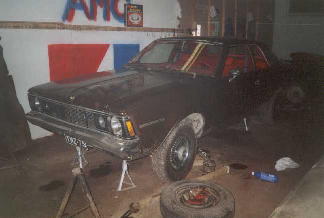

Click here for a garage pic. and Click here for a pic with the new front grille (kinda dark though)

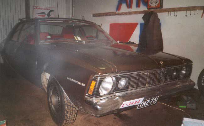

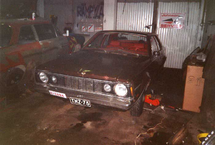

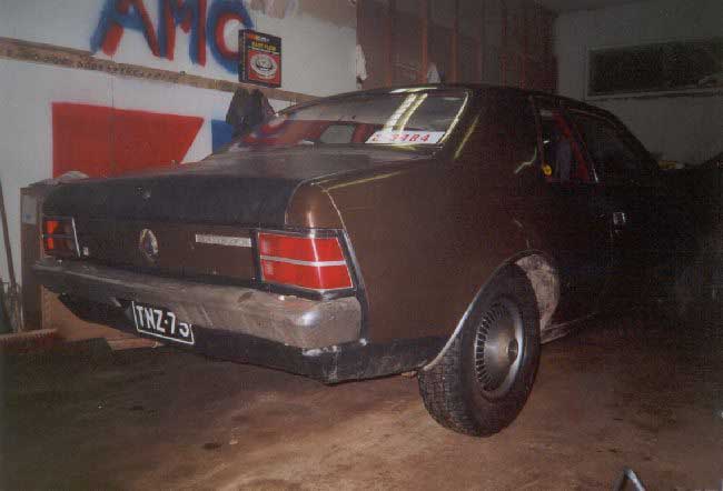

The car had stood under a pinetree for 2 years, since there was no room in the garage for it. The paint had turned green with moss and crome had faded away quite badly, but the car had every single emblem on it, on the outside and inside. All original parts were there, 'front headlight doors' were good as new (if faded) no real rust was visible, and after closer inspection (I learned from my first mistake) the floors were quite solid with just a few spots of rust here and there, no holes. Even better, the seller knew the entire story of the car, even if he had no real evidence, except ownership papers to prove it, the story had a ring of truth to it.
The first owner had driven the car on weekends from '70 when she bought it until '88 when another car had bumped the left front fender. The damage wasn't bad, and it was fixed right away in a good metal/paint shop (the fixup is still nice, and original colors were used), but the granny (was turning 80 years old) got a bit taken back and he got too careful, and stopped driving the car. The car stood in a warm garage for 7 years, engine was in good condition so she or someone else must have started it up every now and then. In the fall of '95 she passed away, and the second owner bought the car off an estate sale for fairly cheap (8000mk). When I saw the car, it had seen a total of 89k kilometers. That's it! Just 89K kilometers and the engine was still in original AMC blue!

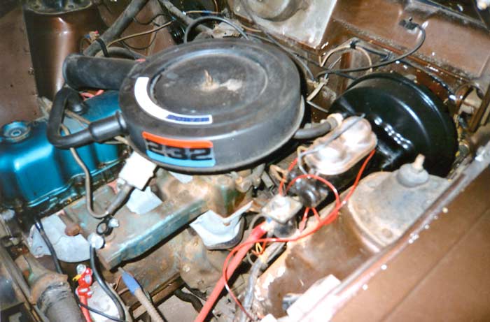

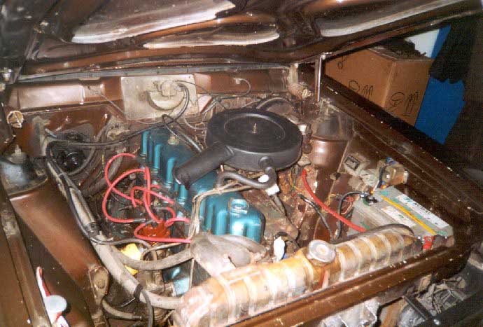

| Engine | 232cid, low milage (89tkm) | Just what I thought, actually better, no work had been done to the engine, original paint, everything was cool. Carb was a bit wasted and the exhaust manifold was leaking though.. | I took out the exhaust manifold and along with cleaning it and painting it with zinc paint, I changed all the gaskets for intake as well. The carb wasn't working as it should, so I basically just took it apart, cleaned everything and put it back together. |

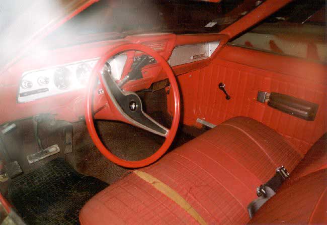

| Interior | All messed up, seemed original | Original interior, only just one small rip in the driver's seat. | After 4 hours of cleaning I finally got the interior rid of all the mildew and moss that had grown there. The seats actually are in better shape than my V8 Hornet ones, structurally, and this confirms that the car is a very low milage one. I also repaired the rubber-carpet, which had tears in several places with fishing line, so it look better now. I might still replace it with a new carpet made of red cloth.. we'll see... Also the arm-rests were trashed so I replaced them with '71 kind, which not only look better but work better as well. Looks decent now. |

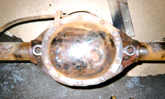

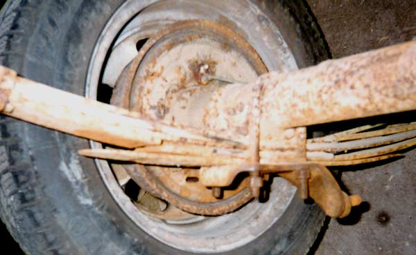

| Underbody | Car steered alright, rode straight, seemed ok. | Other than the fact that the driver's side rear leafspring was cut in several places everything was fine. | Replaced the rear springs with corresponding V8 springs, also removed the rear, painted the rear/shocks (almost new shocks btw) bright red. All rubbers were ok, so not a lot of useless stuff to do there either. |

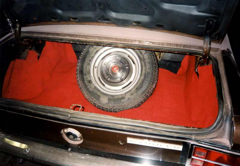

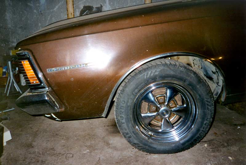

| Tires&Wheels | Original wheels with hubcaps, tiresize was 185/80-14 all-around | Original hubcaps were quite worn and one was dented in several places (propably flewn off). But the big suprise was in the trunk, another set of 4, and which were basically un-used. very cool. |
The hubcaps were nice sure, but not quite the look I was driving for, so I sold them off (still have a set left though) and put crome wheels (size 14x6) under it and realized it looked VERY COOL indeed. The wheels are crome Mangels, but they're not the typical kind, but look more like cromed American Racing's Torq Thrust II's. The tires are currently studded 185/70/14 winter-tires. |

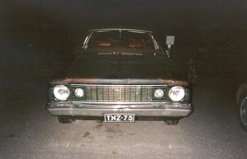

| Others | Front grille was bent out of shape by a previous accident. | Was just that. | First I straightened it out, and kept it like that for a couple months. After this the bends and the fact that it wasn't good looking made me check my spare-parts store for a replacement, and there it was. I cleaned it out and spent hours scrubbing it to make it shine. Well, now it does, but I wouldn't do it again.. =) |

Here are some pictures of the car during various phases of the project.
| Pictures of the Car | |
| Project Pics | |
