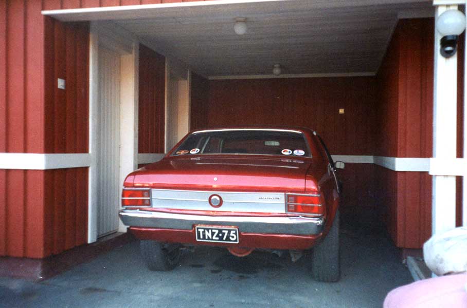

This is almost what it looks like right now. I've added some racing tapes &
markers on the sides but the car is still the same. New pics coming soon...

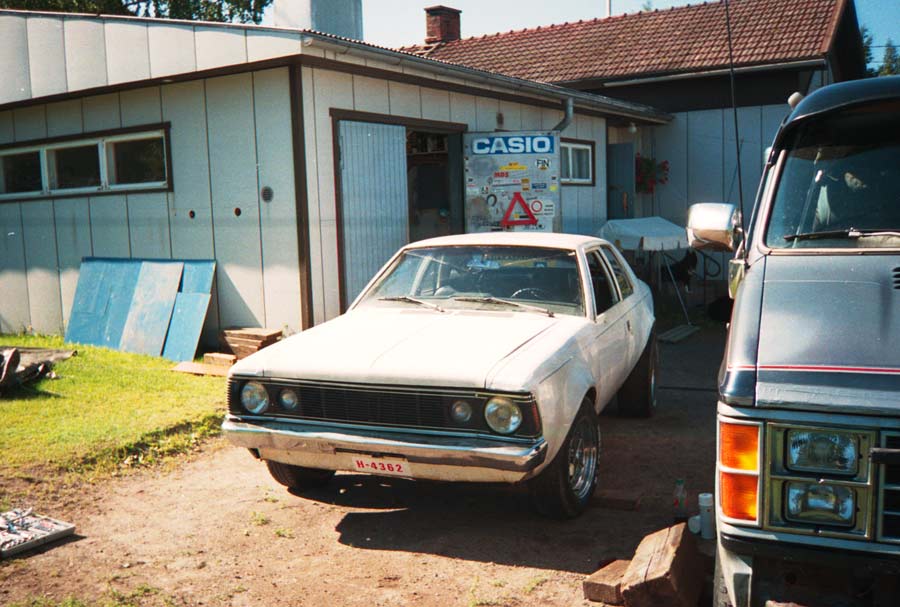

After the all-night trip back home, this is what the car looked
like the next day after dropping it from the truck bed.

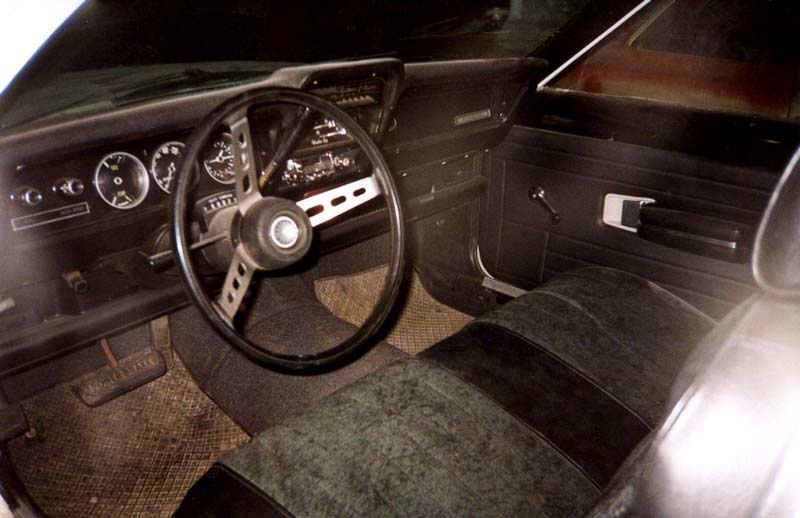

INTERIOR | Looked decent, not original though | Original seats gone, replaced with some strange and small separate japanese ones which were welded in to the body immobile, looked quite nasty after removing the covers. Dash was suprisingly in very good shape, as were most of the plastics and inside electrics. |
Donated the jap-seats to a friend of mine and installed original Hornet seats from a parts-car and had them redone. Also redid and replaced some of the broken interior parts (armrests and such). Also the interior is now completely black, meaning I replaced plastic parts here and there taken from the parts car. Replaced a few bulbs and wires and now the dome light works along with everything else. I had the bench seat in the car for about 2 years and then it broke down (springs) so I installed buckets that are similar to the ones originally available for Hornet. I also had them redone in the same way with the rest of the interior and it looks OK for now.. Thanks to Ake Råberg for all the hard work and help on the interior!. |

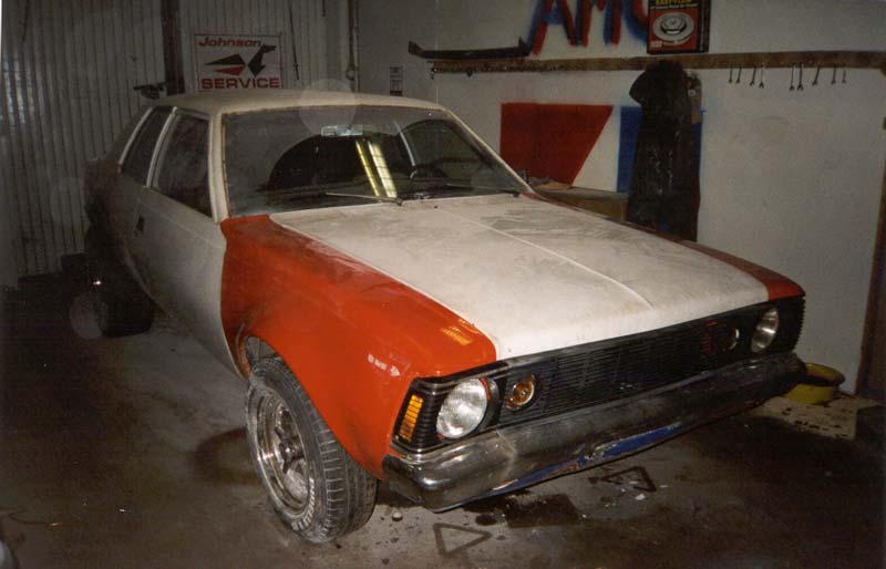

PAINT | White, looked quite decent | Painted over a few times, really faded, some paint wasted out with water, alltogether quite sad. I think the original paint in the car wasn't arctic white but more to a creamy white, the original coat of paint was visible from a couple spots (like when the wipermotor's cover was removed)... | The effort was made to make the car look good, and I gave over the painting to my uncle Timo Nauha. He did most of the underwork (1/2) and because the old paint would have boiled under the new paint, he underpainted the whole car (1/2/3/4) and then fine-sanded the underpaint (1/2) to see if he missed any dents on the surface. Finally he painted the car, first the white and after drying he masked it and then the red & blue. (front shot/rear shot). A Huge thanks goes out to my painter for all the hard work he put in to the car. After 3 years the paintjob is still looking very good, thanks to the painter! |

Removed all the paint from the floor by 'scrubbing' it off and got the rustwork started. Next I cut out the rusted rear floor panels and replaced new sheetmetal. Also bought and installed new front fenders/2 . Left rear fender was totally shot and it was removed. After some modeling, the new fender was spotwelded in, and after checking out everything, it was welded in. Luckily the right fender was fixable without a replacement. Front valance was also replaced. The car is totally rustfree now. |
